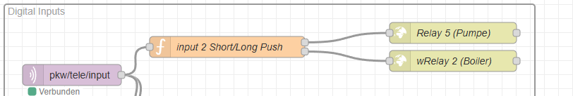

Hab hier noch eine Funktion für einen Taster gebaut, der zwischen lang und kurz unterscheidet.
Damit hab ich 2 Ausgänge, sprich 2 Relays die man schalten kann mit einem Taster.
Bei mir habe ich den Input 2 genommen und gehe mit kurzen druck auf Relay 5 und mit langen druck auf ein Wireless Relay 2. Hier mein Code:
[{"id":"b0d41d4b2b96b160","type":"function","z":"d8be6ba2a43f7c48","g":"6534c8572f823597","name":"input 2 Short/Long Push","func":"let timestamp = Date.now();  // Aktuellen Zeitstempel erhalten\nlet lastPushTime2 = context.get('lastPushTime2') || 0;\n\nlet pressDuration = timestamp - lastPushTime2;  //Zeitdifferenz\n\nif (msg.payload.input === 2) { // Input 2\n    if (msg.payload.status === true) {\n        // Taste gedrückt\n        context.set('lastPushTime2', timestamp);\n        msg.payload.type = 'Press started'; // Taste gedrückt\n    } else if (msg.payload.status === false) {\n        // Taste losgelassen\n        if (pressDuration <= 1000) {\n            // Kurz Push erkannt\n            msg.payload.type = 'Short Push';\n            return [msg, null]; //ersten Ausgang\n        } else if (pressDuration > 1000) {\n            // Long Push erkannt\n            msg.payload.type = 'Long Push';\n            return [null, msg]; //zweiten Ausgang\n        }\n    }\n}\n\nreturn [null, null];","outputs":2,"timeout":0,"noerr":0,"initialize":"","finalize":"","libs":[],"x":350,"y":1520,"wires":[["834dbdcbfde4673b"],["302991f09b7b3288"]]},{"id":"8a57109ada5726f2","type":"mqtt in","z":"d8be6ba2a43f7c48","g":"6534c8572f823597","name":"","topic":"pkw/tele/input","qos":"2","datatype":"auto-detect","broker":"0ddb07c65cbb68bc","nl":false,"rap":true,"rh":0,"inputs":0,"x":130,"y":1560,"wires":[["762ed117e2f8ec45","1f94cd6a0ee719c5","b0d41d4b2b96b160"]]},{"id":"302991f09b7b3288","type":"http request","z":"d8be6ba2a43f7c48","g":"6534c8572f823597","name":"wRelay 2 (Boiler)","method":"PUT","ret":"txt","paytoqs":"ignore","url":"http://127.0.0.1:1880/toggle/wrelay/2","tls":"","persist":false,"proxy":"","insecureHTTPParser":false,"authType":"","senderr":false,"headers":[],"x":670,"y":1540,"wires":[[]]},{"id":"834dbdcbfde4673b","type":"http request","z":"d8be6ba2a43f7c48","g":"6534c8572f823597","name":"Relay 5 (Pumpe)","method":"PUT","ret":"txt","paytoqs":"ignore","url":"http://127.0.0.1:1880/toggle/relay/5","tls":"","persist":false,"proxy":"","insecureHTTPParser":false,"authType":"","senderr":false,"headers":[],"x":670,"y":1500,"wires":[[]]},{"id":"0ddb07c65cbb68bc","type":"mqtt-broker","name":"","broker":"http://localhost","port":"1883","clientid":"","autoConnect":true,"usetls":false,"protocolVersion":"4","keepalive":"60","cleansession":true,"birthTopic":"","birthQos":"0","birthPayload":"","birthMsg":{},"closeTopic":"","closeQos":"0","closePayload":"","closeMsg":{},"willTopic":"","willQos":"0","willPayload":"","willMsg":{},"sessionExpiry":""}]

Könntest du mir bitte einen Screeshot von deinem Backend machen, wie es dann aussehen soll?
Mache da eingentlich nichts, da ich mich damit nicht auskenne.
Der code erzeugt dann die ganzen Blöcke? wie beim Blockly script?

So sieht es dann aus :wink:
Vielen Danke,
Importiert, angepasst und funktioniert .
