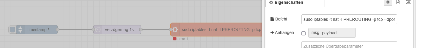

[{"id":"ebe582902f8d4ff8","type":"alexa-home","z":"b9b45e0d0190bae5","devicename":"Deckenlicht","devicetype":"Extended color light","x":370,"y":340,"wires":[["9470e78b5a8fc941","8a1ae1fdc339902c"]]},{"id":"89f22c7e7cb33064","type":"alexa-home-controller","z":"b9b45e0d0190bae5","controllername":"Alexa Controller","port":60000,"maxItems":25,"x":400,"y":160,"wires":[]},{"id":"beda377e7e0f1671","type":"inject","z":"b9b45e0d0190bae5","name":"","props":[{"p":"payload"},{"p":"topic","vt":"str"}],"repeat":"","crontab":"","once":true,"onceDelay":0.1,"topic":"","payloadType":"date","x":390,"y":80,"wires":[["1b99139942b63d7b"]]},{"id":"1b99139942b63d7b","type":"delay","z":"b9b45e0d0190bae5","name":"","pauseType":"delay","timeout":"1","timeoutUnits":"seconds","rate":"1","nbRateUnits":"1","rateUnits":"second","randomFirst":"1","randomLast":"5","randomUnits":"seconds","drop":false,"outputs":1,"x":660,"y":80,"wires":[["6e83b056d36a49f1"]]},{"id":"6e83b056d36a49f1","type":"exec","z":"b9b45e0d0190bae5","command":"sudo iptables -t nat -I PREROUTING -p tcp --dport 80 -j REDIRECT --to-ports 60000","addpay":false,"append":"","useSpawn":"false","timer":"","winHide":false,"oldrc":false,"name":"","x":1130,"y":80,"wires":[[],[],[]]},{"id":"9470e78b5a8fc941","type":"debug","z":"b9b45e0d0190bae5","name":"","active":true,"tosidebar":true,"console":false,"tostatus":false,"complete":"false","statusVal":"","statusType":"auto","x":630,"y":280,"wires":[]},{"id":"3e0a47be15fd0434","type":"link out","z":"b9b45e0d0190bae5","name":"Alexa/relay1/POWER","mode":"link","links":["23311316e6f23903"],"x":895,"y":340,"wires":[]},{"id":"8a1ae1fdc339902c","type":"change","z":"b9b45e0d0190bae5","name":"Set global relay","rules":[{"t":"set","p":"one","pt":"global","to":"payload.on","tot":"msg"},{"t":"set","p":"payload","pt":"msg","to":"payload.on","tot":"msg"}],"action":"","property":"","from":"","to":"","reg":false,"x":660,"y":340,"wires":[["3e0a47be15fd0434"]]}]

ich habe jetzt endlich mal versucht deine Alexa einzusetzen, aber bei der EXEC Node gibt es eine Fehlermeldung.
dieser Befehl passt wohl nicht mehr zum neuen System.
“Command failed: sudo iptables -t nat -I PREROUTING -p tcp --dport 80 -j REDIRECT --to-ports 60000↵sudo: iptables: command not found↵”
