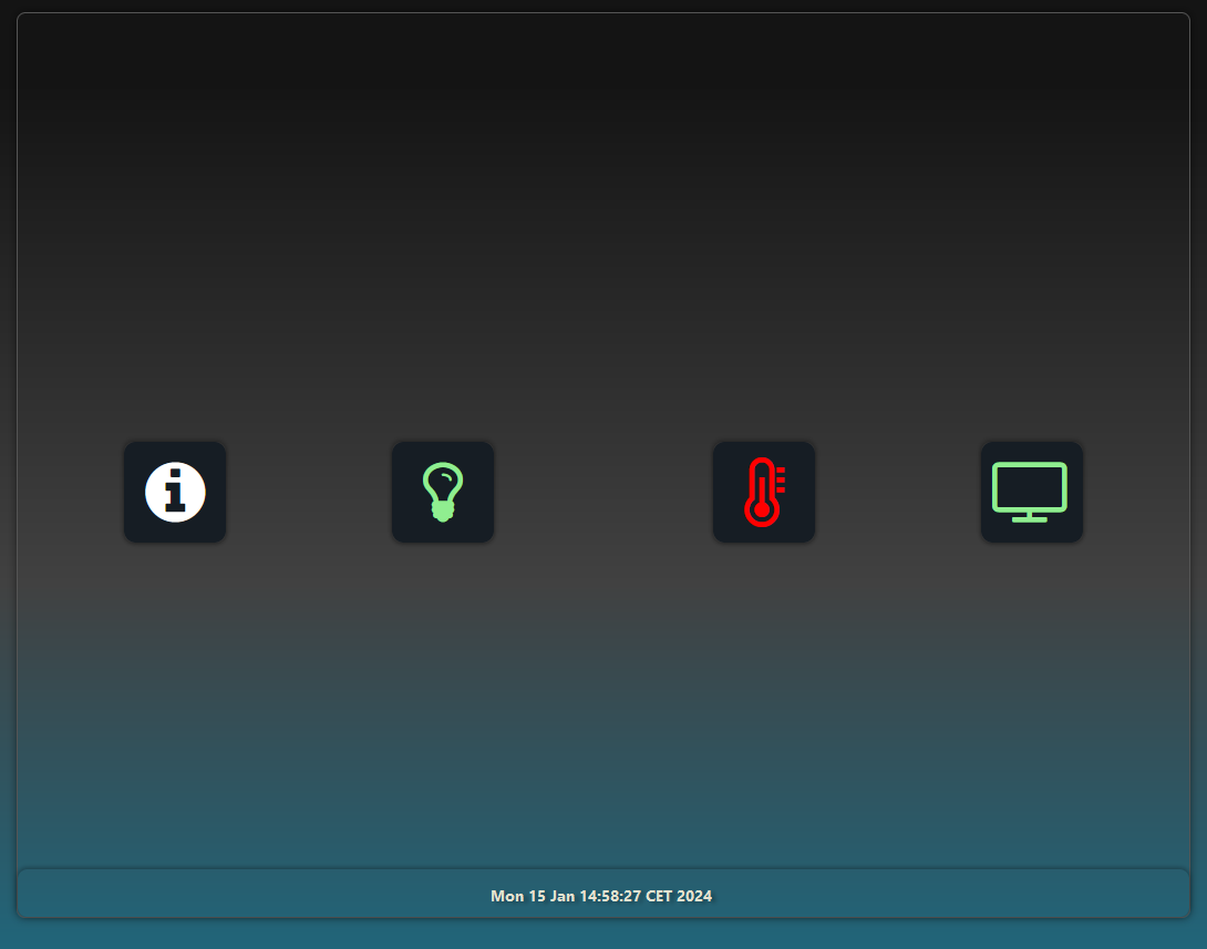

Hallo @Ueberflieger1984
So oder so ähnlich könnte Dein Startbildschirm aussehen.
[{"id":"f1779a1a22539bee","type":"tab","label":"Start","disabled":false,"info":"","env":[]},{"id":"de7dbe34dd4c542d","type":"ui_button","z":"f1779a1a22539bee","name":"Info","group":"29a7f2f05da7b48d","order":10,"width":2,"height":2,"passthru":false,"label":"","tooltip":"","color":"#FFFFFF  ","bgcolor":"#161d24","className":"","icon":"fa-info-circle fa-5x","payload":"Info","payloadType":"str","topic":"topic","topicType":"msg","x":430,"y":100,"wires":[["541b7d70bfaa0488"]]},{"id":"115b141e71e0d343","type":"ui_ui_control","z":"f1779a1a22539bee","name":"Info","events":"change","x":610,"y":320,"wires":[[]]},{"id":"7fabc68f3dae44fb","type":"ui_button","z":"f1779a1a22539bee","name":"Schalter","group":"29a7f2f05da7b48d","order":12,"width":2,"height":2,"passthru":false,"label":"","tooltip":"","color":"lightGreen","bgcolor":"#161d24","className":"","icon":"fa-lightbulb-o fa-5x","payload":"Switches","payloadType":"str","topic":"topic","topicType":"msg","x":420,"y":140,"wires":[["541b7d70bfaa0488"]]},{"id":"b560079f743a10af","type":"ui_ui_control","z":"f1779a1a22539bee","name":"Switches","events":"change","x":620,"y":420,"wires":[[]]},{"id":"545b4f4061891341","type":"ui_button","z":"f1779a1a22539bee","name":"Heizung","group":"29a7f2f05da7b48d","order":14,"width":2,"height":2,"passthru":false,"label":"","tooltip":"","color":"red","bgcolor":"#161d24","className":"","icon":"fa-thermometer-3 fa-5x","payload":"Heater","payloadType":"str","topic":"topic","topicType":"msg","x":420,"y":180,"wires":[["541b7d70bfaa0488"]]},{"id":"d8d5a6267c60f17a","type":"ui_ui_control","z":"f1779a1a22539bee","name":"Heater","events":"change","x":610,"y":460,"wires":[[]]},{"id":"4c6b646949099764","type":"ui_button","z":"f1779a1a22539bee","name":"Monitor","group":"29a7f2f05da7b48d","order":16,"width":2,"height":2,"passthru":false,"label":"","tooltip":"","color":"lightGreen","bgcolor":"#161d24","className":"","icon":"fa-television fa-5x","payload":"Monitor","payloadType":"str","topic":"topic","topicType":"msg","x":420,"y":220,"wires":[["541b7d70bfaa0488"]]},{"id":"bfacf2a925e90cf5","type":"ui_ui_control","z":"f1779a1a22539bee","name":"Monitor","events":"change","x":620,"y":500,"wires":[[]]},{"id":"c29f88dc099de222","type":"inject","z":"f1779a1a22539bee","name":"","props":[{"p":"payload"},{"p":"topic","vt":"str"}],"repeat":"1","crontab":"","once":true,"onceDelay":0.1,"topic":"","payload":"","payloadType":"date","x":370,"y":660,"wires":[["43c7c3b3541eb0b3"]]},{"id":"43c7c3b3541eb0b3","type":"exec","z":"f1779a1a22539bee","command":"date","addpay":false,"append":"","useSpawn":"false","timer":"","winHide":false,"oldrc":false,"name":"","x":524,"y":660,"wires":[["5a1372300d350f89"],[],[]]},{"id":"5a1372300d350f89","type":"ui_text","z":"f1779a1a22539bee","group":"29a7f2f05da7b48d","order":29,"width":0,"height":0,"name":"System time (Info)","label":"","format":"{{msg.payload}}","layout":"col-center","className":"","style":false,"font":"","fontSize":"","color":"#000000","x":749,"y":675,"wires":[]},{"id":"acce5183d6f97879","type":"comment","z":"f1779a1a22539bee","name":"von den UI controll benötigst du nur einen ich mache immer mehrere für die Übersicht","info":"","x":760,"y":40,"wires":[]},{"id":"541b7d70bfaa0488","type":"ui_ui_control","z":"f1779a1a22539bee","name":"Start","events":"change","x":610,"y":160,"wires":[[]]},{"id":"46c0624c532cbc3b","type":"ui_button","z":"f1779a1a22539bee","name":"Start","group":"dcfc4576570aad18","order":11,"width":1,"height":1,"passthru":false,"label":"","tooltip":"","color":"lightGreen","bgcolor":"#161d24","className":"","icon":"fa-home  fa-2x","payload":"Start","payloadType":"str","topic":"topic","topicType":"msg","x":370,"y":320,"wires":[["115b141e71e0d343"]]},{"id":"8066a7656f342111","type":"comment","z":"f1779a1a22539bee","name":"hier müsstest du dann auf der Seite Switches Heater Monitor deinen Startbuton setzen um zurück zur Startseite zu kommen so wie bei Info","info":"","x":720,"y":380,"wires":[]},{"id":"3ac45bbe95fdbebc","type":"comment","z":"f1779a1a22539bee","name":"Natürlich kannst du die Buton auch noch alle auf  die Info Schalter Heizungsseite machen dann kannst du von dort auch überall hinspringen.","info":"","x":720,"y":560,"wires":[]},{"id":"ff41d3a84a3c38d8","type":"ui_spacer","z":"f1779a1a22539bee","name":"spacer","group":"29a7f2f05da7b48d","order":1,"width":22,"height":1},{"id":"89fb058e6058be30","type":"ui_spacer","z":"f1779a1a22539bee","name":"spacer","group":"29a7f2f05da7b48d","order":2,"width":22,"height":1},{"id":"f7a4783d18d59ebd","type":"ui_spacer","z":"f1779a1a22539bee","name":"spacer","group":"29a7f2f05da7b48d","order":3,"width":22,"height":1},{"id":"b95b045a816a6887","type":"ui_spacer","z":"f1779a1a22539bee","name":"spacer","group":"29a7f2f05da7b48d","order":4,"width":22,"height":1},{"id":"770bfd81b254f96d","type":"ui_spacer","z":"f1779a1a22539bee","name":"spacer","group":"29a7f2f05da7b48d","order":5,"width":22,"height":1},{"id":"31a716d9e39d3c6e","type":"ui_spacer","z":"f1779a1a22539bee","name":"spacer","group":"29a7f2f05da7b48d","order":6,"width":22,"height":1},{"id":"31e20aa83fc88c6b","type":"ui_spacer","z":"f1779a1a22539bee","name":"spacer","group":"29a7f2f05da7b48d","order":7,"width":22,"height":1},{"id":"503a5bf25a4d51d7","type":"ui_spacer","z":"f1779a1a22539bee","name":"spacer","group":"29a7f2f05da7b48d","order":8,"width":22,"height":1},{"id":"5297e81d68d438df","type":"ui_spacer","z":"f1779a1a22539bee","name":"spacer","group":"29a7f2f05da7b48d","order":9,"width":2,"height":1},{"id":"565714d7fdc58e87","type":"ui_spacer","z":"f1779a1a22539bee","name":"spacer","group":"29a7f2f05da7b48d","order":11,"width":3,"height":1},{"id":"ba1908b5cf92a160","type":"ui_spacer","z":"f1779a1a22539bee","name":"spacer","group":"29a7f2f05da7b48d","order":13,"width":4,"height":1},{"id":"7e22f716849882af","type":"ui_spacer","z":"f1779a1a22539bee","name":"spacer","group":"29a7f2f05da7b48d","order":15,"width":3,"height":1},{"id":"fc9de623caf49f22","type":"ui_spacer","z":"f1779a1a22539bee","name":"spacer","group":"29a7f2f05da7b48d","order":17,"width":2,"height":1},{"id":"1b0537afc58647f6","type":"ui_spacer","z":"f1779a1a22539bee","name":"spacer","group":"29a7f2f05da7b48d","order":18,"width":2,"height":1},{"id":"385a2702a845f484","type":"ui_spacer","z":"f1779a1a22539bee","name":"spacer","group":"29a7f2f05da7b48d","order":19,"width":3,"height":1},{"id":"f222ac8359ade787","type":"ui_spacer","z":"f1779a1a22539bee","name":"spacer","group":"29a7f2f05da7b48d","order":20,"width":4,"height":1},{"id":"f743ead52fd4d6fc","type":"ui_spacer","z":"f1779a1a22539bee","name":"spacer","group":"29a7f2f05da7b48d","order":21,"width":3,"height":1},{"id":"c40e14cbcbc0f752","type":"ui_spacer","z":"f1779a1a22539bee","name":"spacer","group":"29a7f2f05da7b48d","order":22,"width":2,"height":1},{"id":"2fdf03fd11188cc5","type":"ui_spacer","z":"f1779a1a22539bee","name":"spacer","group":"29a7f2f05da7b48d","order":23,"width":22,"height":1},{"id":"6ea05700aaf82e07","type":"ui_spacer","z":"f1779a1a22539bee","name":"spacer","group":"29a7f2f05da7b48d","order":24,"width":22,"height":1},{"id":"02e33a6284cd616f","type":"ui_spacer","z":"f1779a1a22539bee","name":"spacer","group":"29a7f2f05da7b48d","order":25,"width":22,"height":1},{"id":"c490f34489216401","type":"ui_spacer","z":"f1779a1a22539bee","name":"spacer","group":"29a7f2f05da7b48d","order":26,"width":22,"height":1},{"id":"490a7c20ee3c5a1b","type":"ui_spacer","z":"f1779a1a22539bee","name":"spacer","group":"29a7f2f05da7b48d","order":27,"width":22,"height":1},{"id":"25843512bea5017c","type":"ui_spacer","z":"f1779a1a22539bee","name":"spacer","group":"29a7f2f05da7b48d","order":28,"width":22,"height":1},{"id":"3cb6c2d7d7b67806","type":"ui_spacer","z":"f1779a1a22539bee","name":"spacer","group":"dcfc4576570aad18","order":10,"width":2,"height":1},{"id":"e07ee0e7af3cd9cb","type":"ui_spacer","z":"f1779a1a22539bee","name":"spacer","group":"dcfc4576570aad18","order":12,"width":6,"height":1},{"id":"5269785ea2d08f32","type":"ui_spacer","z":"f1779a1a22539bee","name":"spacer","group":"d7b10e4dc1f23ce3","order":4,"width":3,"height":1},{"id":"23121089d8f787c1","type":"ui_spacer","z":"f1779a1a22539bee","name":"spacer","group":"d7b10e4dc1f23ce3","order":5,"width":3,"height":1},{"id":"e3e32db0cd2a4321","type":"ui_spacer","z":"f1779a1a22539bee","name":"spacer","group":"d7b10e4dc1f23ce3","order":6,"width":3,"height":1},{"id":"29a7f2f05da7b48d","type":"ui_group","name":"Start","tab":"2d044026ae0be343","order":1,"disp":false,"width":22,"collapse":false,"className":""},{"id":"dcfc4576570aad18","type":"ui_group","name":"Time to Go","tab":"deee53a800de461d","order":1,"disp":true,"width":"6","collapse":true,"className":""},{"id":"d7b10e4dc1f23ce3","type":"ui_group","name":"Victron Shunt","tab":"deee53a800de461d","order":8,"disp":true,"width":"6","collapse":true,"className":""},{"id":"2d044026ae0be343","type":"ui_tab","name":"Start","icon":"fa-home fa-3x","order":1,"disabled":false,"hidden":false},{"id":"deee53a800de461d","type":"ui_tab","name":"Info","icon":"mi-info","order":3,"disabled":false,"hidden":false}]
Wenn du den Code kopierst, dann kannst du den in Nodered oben rechts die 3 Striche Importieren.
Das ist nur eine Starthilfe.

mit dem “fa-5x” veränderst du die Größe

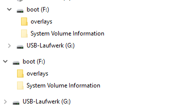

Ich habe mir das nun alles nach meinen Wünschen angepasst - also ist die SD-Karte für mich schon recht wertvoll.
Wie kann ich eine 1 zu 1 Kopie der SD-Karte erstellen?
Mit den ChatGPT-Erläuterungen zu Image-Kopien komme ich nicht weiter - es sind einfach zu viele komische Dateien / Ordner auf der SD-Karte.
Könnt Ihr mir sagen wie ich einfach die aktuelle SD-Karte kopieren kann?
@Ueberflieger1984 Schau mal hier im dritten Absatz
mit Win32DiskImager kannst du deine Karte klonen
