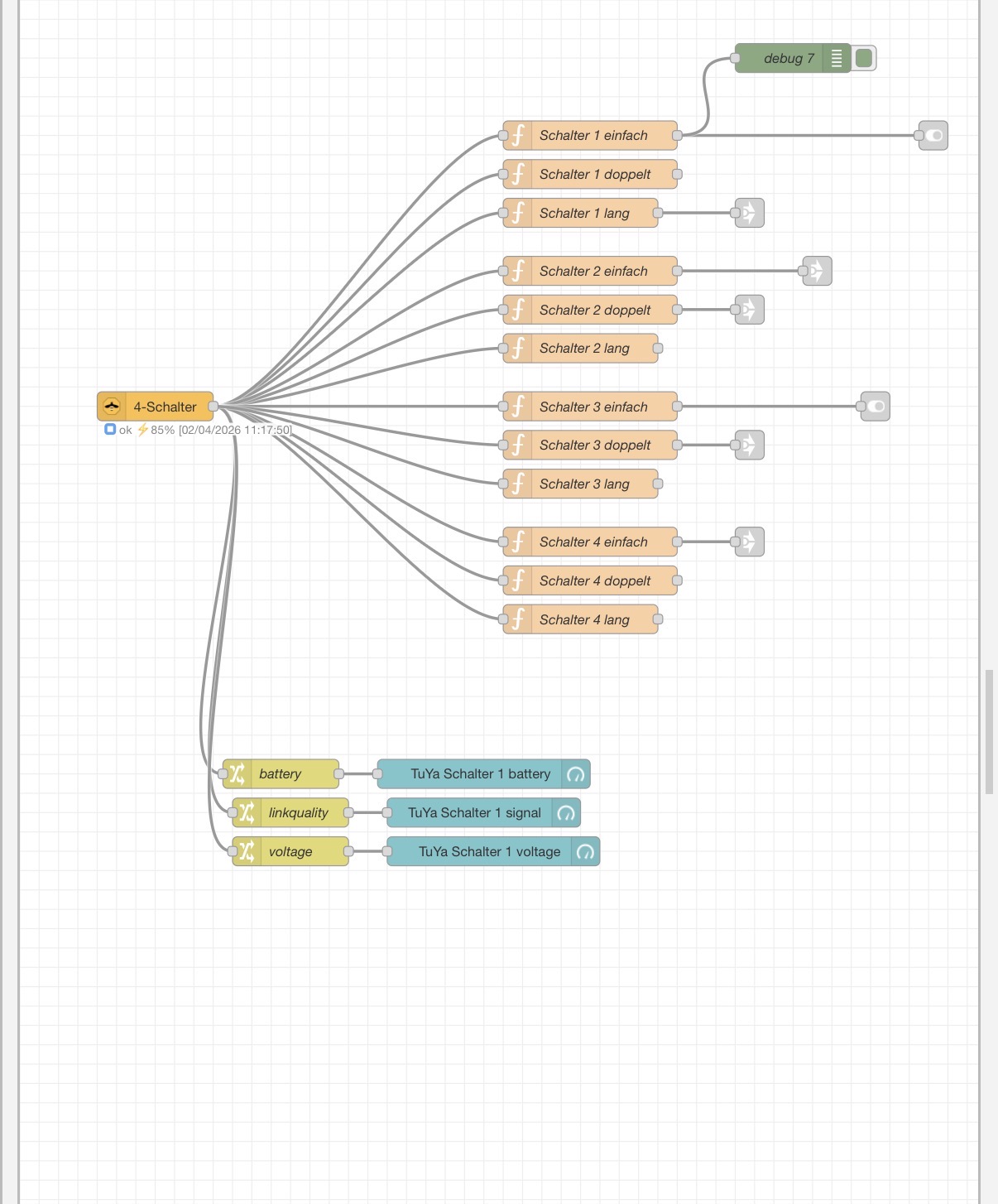

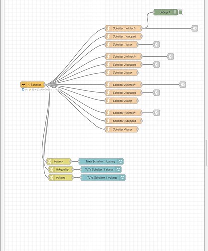

Hey ich habe mir den Tula oder MOES 4-fach Taster zugelegt und würde den gern einbinden. Allerdings habe ich hier ein paar Probleme. Anbei der aktuelle flow:
[{"id":"6694d467a3aa66dc","type":"zigbee2mqtt-in","z":"e8edd75515535763","name":"","server":"36746ccac661caef","friendly_name":"Tuya Taster 4fach (TS0044)","device_id":"0xa4c1381c3077e11d","state":"0","outputAtStartup":true,"filterChanges":false,"enableMultiple":false,"x":170,"y":1300,"wires":[["d0604bd11e3fbc05"]]},{"id":"d0604bd11e3fbc05","type":"json","z":"e8edd75515535763","name":"","property":"payload","action":"","pretty":false,"x":470,"y":1300,"wires":[["738a48ec1f915a7b","71c71f651f5b69ab","9e9e89663e84d3e5","3fd3fbc55e8f68fd","1fa509d51e1a6305"]]},{"id":"738a48ec1f915a7b","type":"debug","z":"e8edd75515535763","name":"","active":true,"tosidebar":true,"console":false,"tostatus":false,"complete":"true","targetType":"full","x":630,"y":1240,"wires":[]},{"id":"71c71f651f5b69ab","type":"switch","z":"e8edd75515535763","name":"","property":"payload.action","propertyType":"msg","rules":[{"t":"eq","v":"1_single","vt":"str"},{"t":"eq","v":"2_single","vt":"str"},{"t":"eq","v":"3_single","vt":"str"},{"t":"eq","v":"4_single","vt":"str"},{"t":"eq","v":"1_hold","vt":"str"},{"t":"eq","v":"2_hold","vt":"str"},{"t":"eq","v":"3_hold","vt":"str"},{"t":"eq","v":"4_hold","vt":"str"},{"t":"eq","v":"1_double","vt":"str"},{"t":"eq","v":"2_double","vt":"str"},{"t":"eq","v":"3_double","vt":"str"},{"t":"eq","v":"4_double","vt":"str"}],"checkall":"true","repair":false,"outputs":12,"x":630,"y":1360,"wires":[["76c483a95f89a656"],["1dd00e7f2a7a0776"],["828a9c7e14a2de62"],["63e905e1ae2b86e9"],["cc701a5c7540eb83"],["1809b4de88b2e4d3"],["66640abb09a29d09"],["08432c4a1abf1c55"],["8412e1b99107b76a"],["c0b3c3567f960694"],["06daff4f4a318be5"],["587197ba1c720c7e"]]},{"id":"ca2cd0caa998e5d0","type":"comment","z":"e8edd75515535763","name":"4x Tuya switch TS0044: ","info":"","x":320,"y":1180,"wires":[]},{"id":"76c483a95f89a656","type":"debug","z":"e8edd75515535763","name":"Short press 1","active":true,"tosidebar":true,"console":false,"tostatus":false,"complete":"true","targetType":"full","statusVal":"","statusType":"auto","x":940,"y":1160,"wires":[]},{"id":"1dd00e7f2a7a0776","type":"debug","z":"e8edd75515535763","name":"Short press 2","active":true,"tosidebar":true,"console":false,"tostatus":false,"complete":"true","targetType":"full","statusVal":"","statusType":"auto","x":940,"y":1200,"wires":[]},{"id":"828a9c7e14a2de62","type":"debug","z":"e8edd75515535763","name":"Short press 3","active":true,"tosidebar":true,"console":false,"tostatus":false,"complete":"true","targetType":"full","statusVal":"","statusType":"auto","x":940,"y":1240,"wires":[]},{"id":"63e905e1ae2b86e9","type":"debug","z":"e8edd75515535763","name":"Short press 4","active":true,"tosidebar":true,"console":false,"tostatus":false,"complete":"true","targetType":"full","statusVal":"","statusType":"auto","x":940,"y":1280,"wires":[]},{"id":"cc701a5c7540eb83","type":"debug","z":"e8edd75515535763","name":"Long press 1","active":true,"tosidebar":true,"console":false,"tostatus":false,"complete":"true","targetType":"full","statusVal":"","statusType":"auto","x":930,"y":1480,"wires":[]},{"id":"1809b4de88b2e4d3","type":"debug","z":"e8edd75515535763","name":"Long press 2","active":true,"tosidebar":true,"console":false,"tostatus":false,"complete":"true","targetType":"full","statusVal":"","statusType":"auto","x":930,"y":1520,"wires":[]},{"id":"66640abb09a29d09","type":"debug","z":"e8edd75515535763","name":"Long press 3","active":true,"tosidebar":true,"console":false,"tostatus":false,"complete":"true","targetType":"full","statusVal":"","statusType":"auto","x":930,"y":1560,"wires":[]},{"id":"08432c4a1abf1c55","type":"debug","z":"e8edd75515535763","name":"Long press 4","active":true,"tosidebar":true,"console":false,"tostatus":false,"complete":"true","targetType":"full","statusVal":"","statusType":"auto","x":930,"y":1600,"wires":[]},{"id":"8412e1b99107b76a","type":"debug","z":"e8edd75515535763","name":"Double press 1","active":true,"tosidebar":true,"console":false,"tostatus":false,"complete":"true","targetType":"full","statusVal":"","statusType":"auto","x":940,"y":1320,"wires":[]},{"id":"c0b3c3567f960694","type":"debug","z":"e8edd75515535763","name":"Double press 2","active":true,"tosidebar":true,"console":false,"tostatus":false,"complete":"true","targetType":"full","statusVal":"","statusType":"auto","x":940,"y":1360,"wires":[]},{"id":"06daff4f4a318be5","type":"debug","z":"e8edd75515535763","name":"Double press 3","active":true,"tosidebar":true,"console":false,"tostatus":false,"complete":"true","targetType":"full","statusVal":"","statusType":"auto","x":940,"y":1400,"wires":[]},{"id":"587197ba1c720c7e","type":"debug","z":"e8edd75515535763","name":"Double press 4","active":true,"tosidebar":true,"console":false,"tostatus":false,"complete":"true","targetType":"full","statusVal":"","statusType":"auto","x":940,"y":1440,"wires":[]},{"id":"36746ccac661caef","type":"zigbee2mqtt-server","name":"","host":"localhost","mqtt_port":1883,"mqtt_username":"","mqtt_password":"","mqtt_qos":"0","tls":"","usetls":false,"base_topic":"zigbee2mqtt"}]

Sitze gerade nicht am System, aber es gibt einen zigbee thread von mir, in den hat Arno @ahtdf mir damals ein Beispiel geschickt was ich auch verwende.
Das mit dem dimmen ist nicht so einfach, ich hab mich so abgefunden, 1* klick. 50% 2* Klick 100%
Da ich angesprochen wurde antworte ich natürlich auf das Thema :wink:
Bei mir sieht das so aus: einfach Taste 1 = Lampe 1
Taste 1 Halten bis grüne leuchte ausgeht = hold Funktion = beginn dimmen Lampe1
einfach Taste 1 Dimmen Lampe 1 aus.
doppelt Taste 1 = Lampe 2
Taste 1 Halten bis grüne leuchte ausgeht = hold Funktion = beginn dimmen Lampe2
einfach Taste 1 Dimmen Lampe2 aus.
einfach Taste 2 = Lampe 3
Taste 2 Halten bis grüne leuchte ausgeht = hold Funktion = beginn dimmen Lampe3
einfach Taste 2 Dimmen Lampe 3 aus.
doppelt Taste 2 = Lampe 4
Taste 2 Halten bis grüne leuchte ausgeht = hold Funktion = beginn dimmen Lampe4
einfach Taste 2 Dimmen Lampe4 aus.
Das wiederholt sich bei allen Tastern, auser bei Taster 4, da schaltet der Taster doppelt ein Relay.
Ich werte irgendwo aus welche Taste gedrückt wurde, um mit der Holdfunktion die richtige Lampe zu dimmen.
Da ich die gesamte Dimmergeschichte bei mir aber umgebaut habe, musst du dir überlegen wie du an deine Dimmer drangehst, du hast ja mittlerweile die Möglichkeit die Dimmer über die vorhandenen Eingänge, MCP Input zu steuern, da gibts auch eine holdfunktion zum dimmen. Eventuell kannst du da was umstricken ??? das habe ich mir noch nicht angeschaut, bei mir funktionieert es ja. :wink:

Hier im Anhang mal meine Lösung (Basiert auf Arnos ehemaligem Flow), dies besitzt garkeine “richtige” Dimmfunktion, sondern eben nur eine 50/100/Aus Dimmung, die “Magie” dazu ist oben rechts.
Die Moes/Tuya können Single/Double/Long, hierbei ist:
Single immer 50% wenn vorher aus.
Doppel immer 100%.
Single immer aus, wenn vorher 505 oder 100%
Für alles andere nutze ich das Display oder die App, denn “Push to Dimm” ist für mich immer unbefriedigend, da man den Punkt eh nie Trifft :smiley:
Am besten finde ich da immernoch einen Drehdimmer oder Slider.
