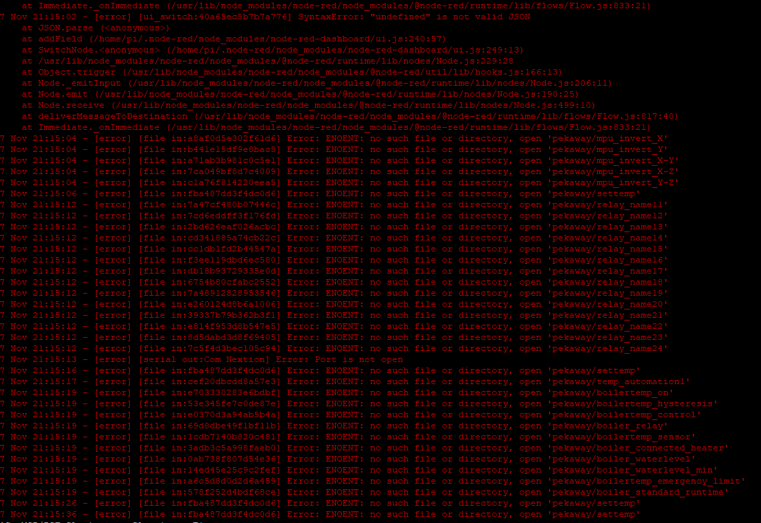

@Vincent Kannst du bitte etwas dazu sagen, warum ich nach dem Update alle Ordner manuell erstellen muss?
welche Ordner musst du neu machen?
Alle, wo pekaway / nodered etwas lesen möchte .
z.B.
[error] [file in:4116525141cf4e0c] Error: ENOENT: no such file or directory, open ‘/home/pi/.node-red/pekaway/update’
[error] [file in:2d0d8eb4b9833540] Error: ENOENT: no such file or directory, open ‘/home/pi/.node-red/pekaway/syncBrowser…’
[error] [file in:a9761702b871796e] Error: ENOENT: no such file or directory, open ‘/home/pi/.node-red/pekaway/mcpinput_al…’
[error] [file in:9870bf1a3c366016] Error: ENOENT: no such file or directory, open ‘/home/pi/.node-red/pekaway/mcpinput_se…’
[error] [file in:5c81a1a1c5f86cd2] ENOENT … /home/pi/.node-red/pekaway/ruuvitag_0_…
[error] [file in:d429a79c452b7b7b] ENOENT … /home/pi/.node-red/pekaway/ruuvitag_1_…
[error] [file in:8da23a7e44a2fc10] ENOENT … /home/pi/.node-red/pekaway/ruuvitag_2_…
[error] [file in:19d15ad5.eedeb5] Error: ENOENT: no such file or directory, open ‘pekaway/shunt’
Nov 07 21:11:44 pekaway Node-RED[1049357]: 7 Nov 21:11:44 - [error] [file in:8c189fcd.f8fcf] Error: ENOENT: no such file or directory, open ‘pekaway/hysteresis’
Nov 07 21:11:44 pekaway Node-RED[1049357]: 7 Nov 21:11:44 - [error] [file in:055d3b76ab5a18e8] Error: ENOENT: no such file or directory, open ‘pekaway/mcpinput_selectedOnlyOff’
Nov 07 21:11:44 pekaway Node-RED[1049357]: 7 Nov 21:11:44 - [error] [file in:411195dc6ac5b9da] Error: ENOENT: no such file or directory, open ‘pekaway/extRelZeitplan’
Nov 07 21:11:48 pekaway Node-RED[1049357]: 7 Nov 21:11:48 - [error] [serial request:9d0a30926aeee2fe] Error: Port is not open
Nov 07 21:11:48 pekaway Node-RED[1049357]: 7 Nov 21:11:48 - [error] [file in:b7c0ceb78de2652a] Error: ENOENT: no such file or directory, open ‘pekaway/savetimer’
Nov 07 21:11:48 pekaway Node-RED[1049357]: 7 Nov 21:11:48 - [error] [file in:2fbb1298cb7fe4e4] Error: ENOENT: no such file or directory, open ‘pekaway/savetimer_autoterm1’
Nov 07 21:11:48 pekaway Node-RED[1049357]: 7 Nov 21:11:48 - [error] [file in:29daf43518bb70e5] Error: ENOENT: no such file or directory, open ‘pekaway/savetimer_autoterm2’
Nov 07 21:11:48 pekaway Node-RED[1049357]: 7 Nov 21:11:48 - [error] [file in:9a8f3887942e7273] Error: ENOENT: no such file or directory, open ‘pekaway/trumatimer’
Nov 07 21:11:48 pekaway Node-RED[1049357]: 7 Nov 21:11:48 - [error] [file in:d86874a889ea986c] Error: ENOENT: no such file or directory, open ‘pekaway/trumatimer_water’
Nov 07 21:11:51 pekaway Node-RED[1049357]: 7 Nov 21:11:51 - [error] [http request:c09495b052b2f61b] RequestError: connect ECONNREFUSED 127.0.0.1:8080
Nov 07 21:11:53 pekaway Node-RED[1049357]: 7 Nov 21:11:53 - [error] [file in:7ca049bf8d7c4009] Error: ENOENT: no such file or directory, open ‘pekaway/mpu_invert_X-Z’
Nov 07 21:11:53 pekaway Node-RED[1049357]: 7 Nov 21:11:53 - [error] [file in:c1a76f814220eea5] Error: ENOENT: no such file or directory, open ‘pekaway/mpu_invert_Y-Z’

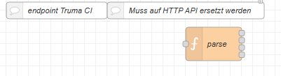

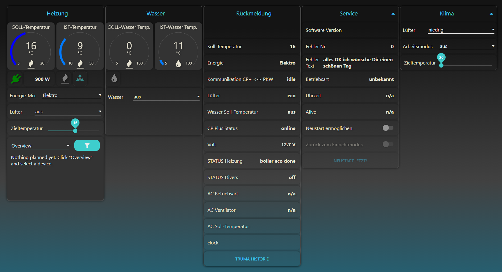

Hallo Arno, dein Flow geht prinzipiell bei mir und steuert die Heizung, ohne etwas zu verändern.
Nur die App geht noch nicht und Telegram.
Was hat es mi diesen Flows auf sich ?
In Telegram kommen nur Störungen bzw. Ok Meldungen.
Das mit der node ersetzen hat sich erledigt, da war irgendwie ein Fehler, und den habe ich damit übergangen???
Die App sollte eigentlich funktionieren die holt sich die MQTT Daten, häng mal Debug Nodes an ob irgendwas undefiniert ist.
